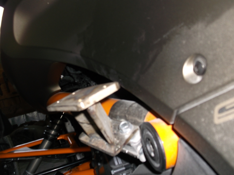

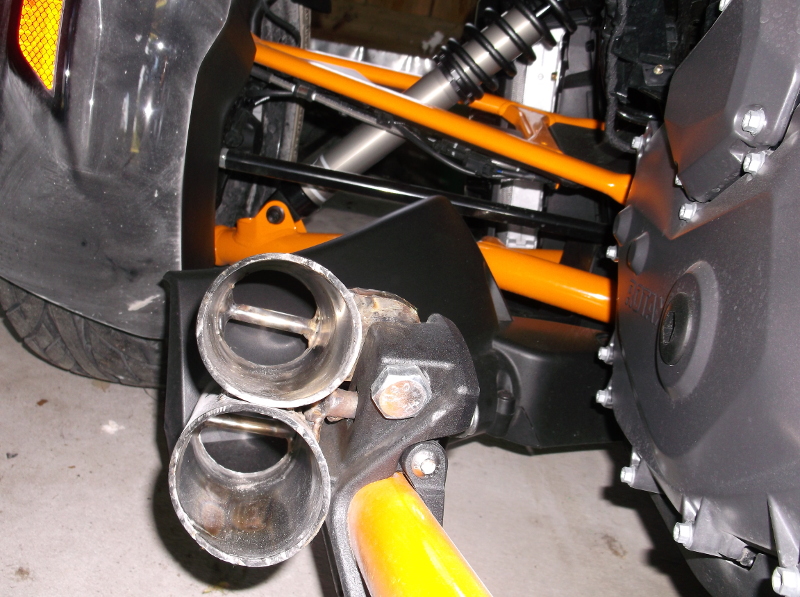

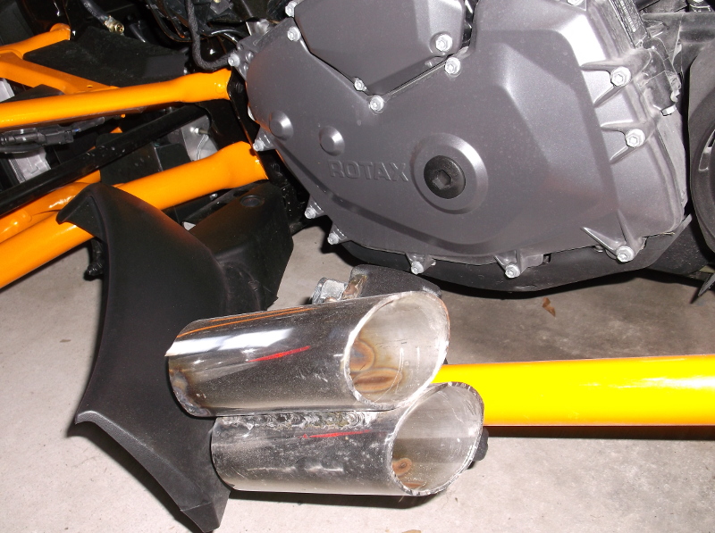

On the front I removed the foot peg from the left side and used the peg mount to hold the lower crutch holders. I realize this would not work for everyone, but I have no left foot, so no need for a left foot peg. Crutch tips slip into the tubes bolted to the peg mount.
It is just some pieces of stainless steel tubing. Some of the older ones were made from muffler pipe. Made these with stainless. They don't rust and can be polished or painted.

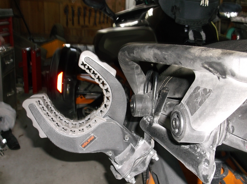

Upper brackets have a Koplin Clamp bolted to the stub outs for the passenger grab rail. The mounts are behind the grab rail and do not interfere with it. Also added some loops to hold bungee cords since the places to tie anything down on the Spyder are very limited.
Very simple and easy.......... just slip the crutch tips in the tubes and lock the tops in the Koplin Clamp

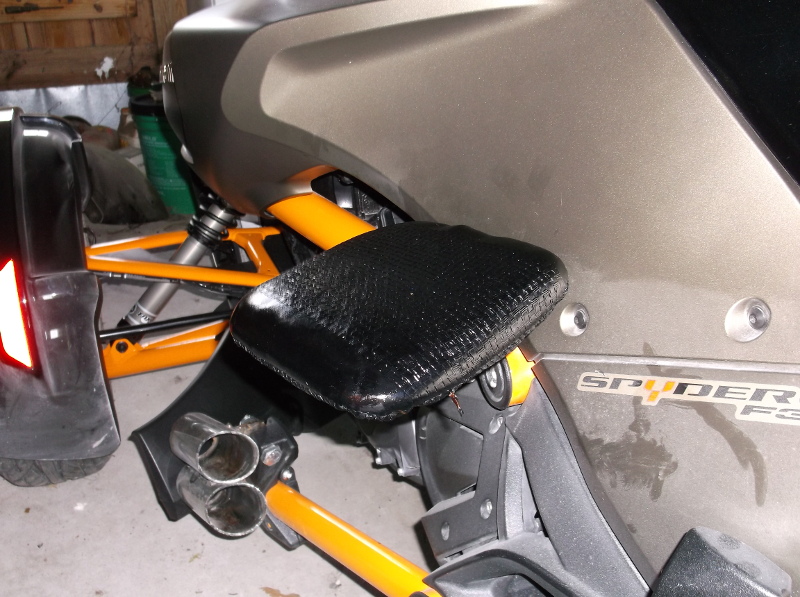

Leg rest to keep the stump of my left leg from just hanging was added also. The leg rest makes it easier to stay balanced and keeps the legs from getting cramps from just hanging and bouncing around on longer rides.

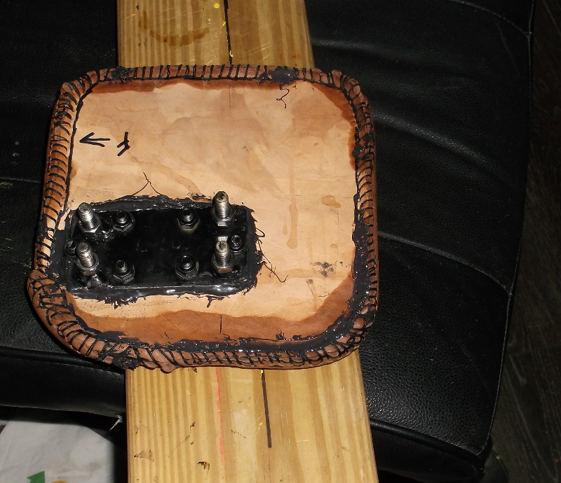

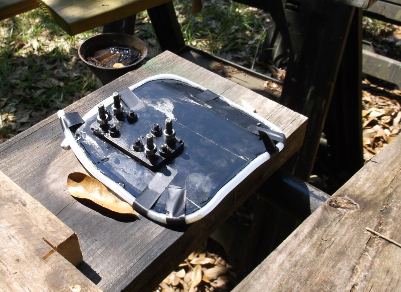

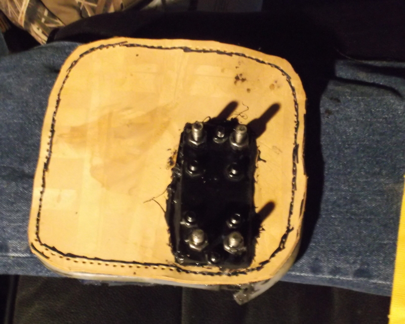

Base plate is just cut from the door of an old electrical box that was on my scrap pile. I split a piece of PVC tubing and glued it to the sharp edges of the base plate, to keep the edges from cutting into the leather cover when that is put on later.

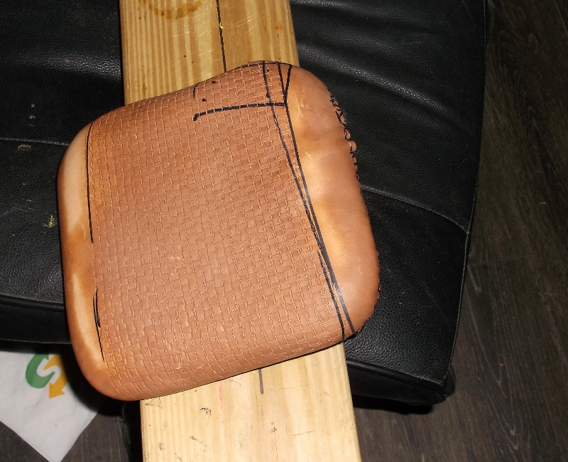

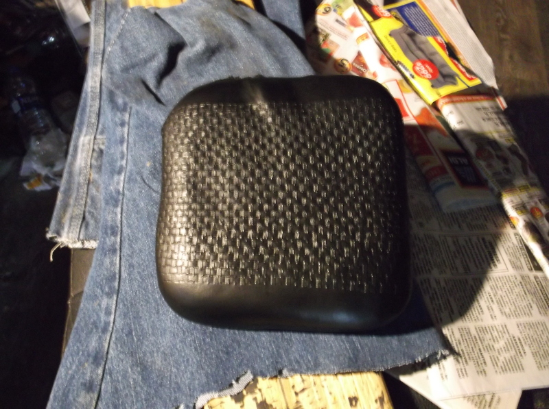

A mounting plate is bolted to the bottom and it is covered with leather. Top side has 1 inch thick jell padding and a piece of 2 inch thick memory foam put on it with contact cement.
Just some sheet leather from Tandy cut and fitted over the foam. I put a basket weave pattern on it, but that is not necessary.
It is mounted to the left side 2 inch tube with a stainless steel muffler clamp, intended to join 2 pieces of muffler pipe, but strong enough to clamp a leg rest on the Spyder tube. The smaller brackets were just cut from stainless steel and drilled to fit. You do not have to make the brackets from stainless. I do it to stop any possibility of rusting and keep it clean looking.
You also would not need to put the extra plate on the mount, but it does give you some adjustment to the angle and height of the pad.

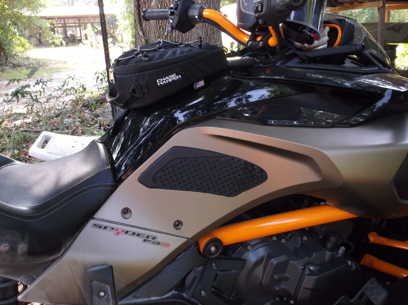

No logo knee grip pads.......... made for Honda CB500, but good fit on F3 Spyder. Protect the sides of tank from scuffs and get better grip with your knees. Around $15.......... Amazon, Ebay, just use google. Come with zero instructions. Not difficult to figure out. Clean area well with grease and tar remover. Clean any residue off with iso - alcohol. Let dry. Peel the side of the 3M sticky pad that goes against the rubber first and apply to the rubber pad. Cut off any overlap with utility knife before sticking to the tank. Next peel the cover from the tank side of the 3M adhesive and stick it on the side of the tank. Careful about alignment......... not going to get a second shot at it.
May or may not need these if you have two feet on the foot pegs, but when one or both legs are missing they will help grip the slick sides of the tank for some aggressive riding.
And they look good too.
