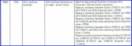

I followed the wire down to a connection right behind the frunk and it didn't appear to be loose. Suppose I should just order a new SE5 shift paddle? Is it item #23 in the diagram? They call it a "switch housing - SE5 semi-automatic" Hopefully it's the switch guts included?
It's obviously an intermittent issue. Hopefully I'm not just replacing a part because there was some moisture in it?
