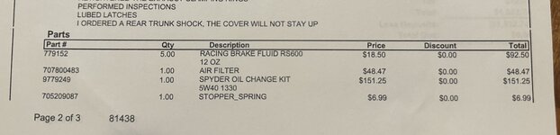

Excellent post. I bought the bike 5k miles ago and got all the service records as the previous owner bought it there, had it serviced there, and traded it for a new one there. I would doubt they didn’t use the Rotex oil change kit. I also know the previous owner didn’t do any servicing themselves. They even had the phone mount installed at the dealer…..
OK, if I'm reading this right:
- The previous owner had the biked serviced at the dealer he purchased it new from, which is the same dealer you purchased it from.
- You did the recent service yourself & used the BRP XPS Oil Change Kit.
If the service record don't specify what oil was used by the dealer, it's entirely possible they used the 44 gal. drum of 'one size fits most' engine oil they buy in bulk. That may be why you've noticed a difference in gear changing performance since you changed it. Maybe?
