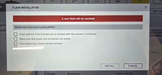

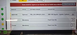

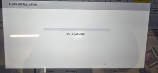

Tried again today using the current version of BUDS3 (dated 15 Oct 2026) and a different usb data cable, (from an external hard drive). Still won't install. Here's 3 screen shots that show what I'm getting from BUDS3. Still, the flashing screen never moves from 0%. The glare from the lights is hiding the bottom check box in the middle photo. That one just says, "Check all".
