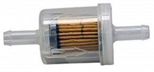

Taking care of Hose #24. This is your fuel tank vent hose, which is required. You need to route and zip tie this hose back along the right side frame to somewhere about mid rear fender. You want to route this vent hose (#3) upward from the fuel tank until it naturally begins to descend to the exit point. This will happen automatically if you follow the frame tube to the back. The existing hose is not long enough to get this far back so you will need to purchase an appropriately sized hose barb (Pictured Below) and another length of hose to extend it. These can be found at any auto parts or lawnmower shop. While you are there get a small fuel filter similar to the one pictured. I like the clear ones so you can see what is going on at the end of your vent hose, but virtually any version will do.
Insert the fuel filter at the end of the fuel tank vent hose you've routed to the rear of your Spyder. Mount it horizontally as pictured. This will keep any foreign substance from entering the vent hose and will also serve to give you indication if any liquid fuel is being pushed through the vent hose as it will collect at the bottom of this filter. This will tell you if you have installed the vent hose correctly. You can clamp these fittings if you like. But it is not necessary. I did not clamp any of mine. A good tight fit is more than sufficient.

PS) This is the fuel filter that I bought. It comes with various size fittings for different sizes of hose. I used 1/4” fittings & 1/4” hose. It is a Mr. Gasket product, #9706; bought at a local auto parts store:
And by installing the filter directly into the line from the gas tank I did not need this:

I recommend running the vent hose up along the right frame tube (sitting on the Spyder) to the back and terminate under the rear fender. The vent tube originates near the right front of the tank. If you have any fumes at all they will exit behind you rather than in front of you. And you avoid being anywhere near the engine, as you will if you go forward. This also keeps the entire vent tube above the fuel tank except for where you go downhill at the very end. This way there is no possibility of any fuel pooling along the way. I put a clear, lawnmower fuel filter (like the one pictured below) at the end of the vent hose so that I can check to see if any liquid fuel is going out and to keep anything from getting in. This has been done many ways. But I still think this is the better way to go.
