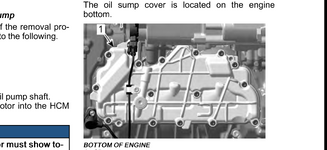

Are you talking about this piece? The first step is to remove the engine. Why in the world would you need to do this?

Having to remove the sump pan is a Very Bad Day. There are a good number of alternatives to fixing a drain plug before going to this nuclear option.
