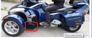

I'm wondering if I can purchase the inner pc that is attached to this black plastic fin that I have circled in red. Last night I noticed that the inner piece is just floating and the plastic pc's that hold the two together are busted.:banghead:
Glue it? With what? or can it be purchased from BRP with out it costing $10,000 "LOL".

I'm guessing that's ~ 2012 RT SE, this looks like what you need from
cheap cycle parts:
35 ​
LH Water Deflector Ass'y
705003759
$30.99​
May I guess that the part has been used as a foot rest; might be better in the long rung to get road pegs or floor boards; Seal is having a free shipping sale currently

the parts are made from ABS plastic so you can go Lowes or Home Depot or your local home improvement store and in the plumbing dept get a small can of of ABS glue.
Both!
Try a repair. If it does not work, you are out just a few dollars. If it does, follow up this post with a fix! Plan "B"? Buy a new one. Good luck! Joe
JB Weld may also work for you. I had a post/tab break off the removable piece above that, and I used JB weld. It's now stronger than it was from the factory.
