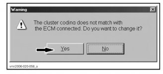

this screen shows now on startup when opening BUDS, after the ECM was updated, goes away when clicked on. Not sure what's happening. Does not seem to affect anything.

I don't know, did not change any thing, just updated the Firm ware in the ECM. It runs fine so I'm not going to worry about it. ;)
Any chance that either the ECM or the Cluster has been replaced over the years? That screen isn't addressed in the manual. If it was a serious problem, you would get this screen instead, (see pic), and the engine would not run. But to double check, ensure you use BUDS and not BUDS2 on your 2013. Ride it.
It's Buds E3.8.2. That screen never appeared till after the firmware update. So not sure why? Over on Facebook, BRP BUDS/BUDS2 TECH where I purchased my System. This was posted in response to my same question there.
(Click on modules at the top menu… then cluster … then security coding.
Then copy past the number from one field to the other. Save then write data.)
So I will be doing that.
