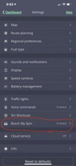

Actually I found out it does work. In the settings of Sygic you’ll find Bosch MySpin and it shows disabled. Choose it and Enable it. Sygic will then work in the dash.

I'm using Sygic with iOS system. It has the Bosch MySpin setting on so it works in the dash. Not sure about Android systems.
