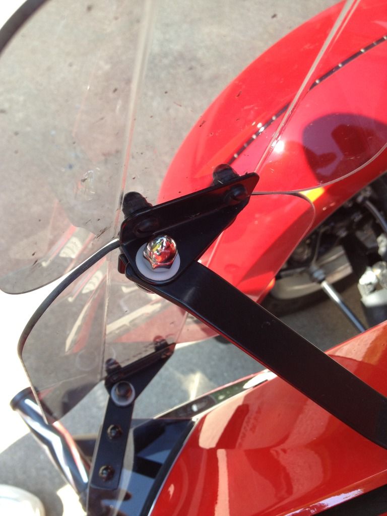

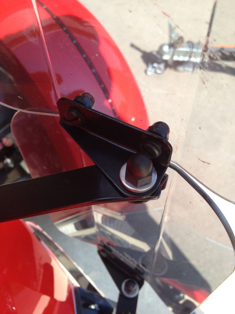

I had my Baker Air Wings installed at SpyderFest this year. One of the things that I noticed over the period of the event was how many of these were installed. Another thing noticed, was how many folks came back needing the top wing on one side or both re tightened. It takes 2 7/16" wrenches BTW. My left side continually had to be tightened. It would start weather veining and become totally useless. I went to tighten it again last night and the acorn nut stripped out. That's when I realized that it wasn't powder coated metal. It was plastic or cheap nylon. I took the stock hardware up to my local store and tried to find a metal acorn nut for it. None of them fit properly, neither metric or English. So, we found another bolt and chrome acorn nut and they work fantastic. This might only be an issue with the folks that got the black hardware instead of the chrome or stainless hardware.

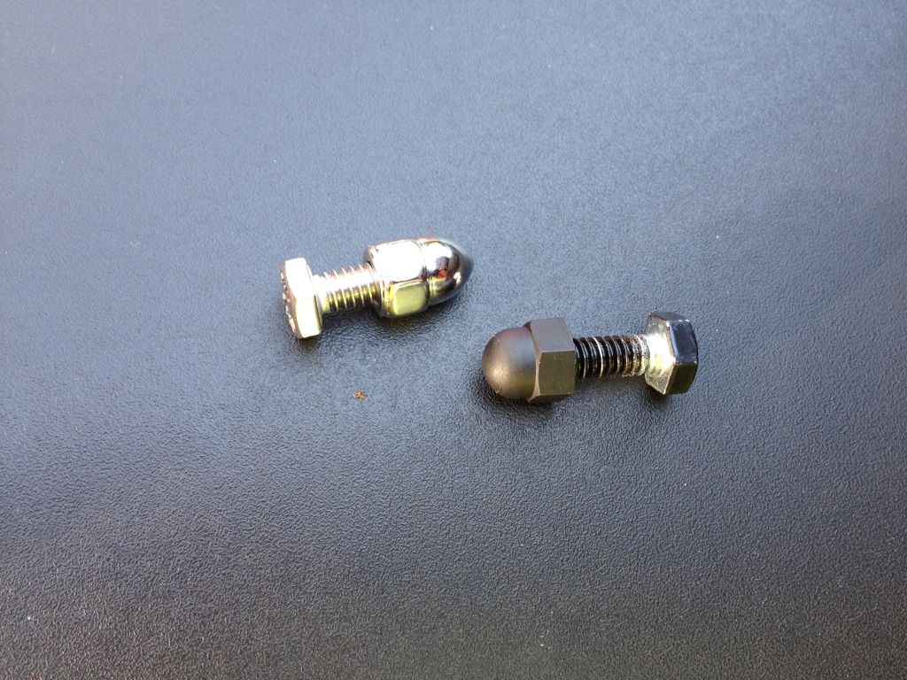

Anyway, here are a few shots of what was purchased and how it looks compared to the original black nut.
Stock hardware
New and improved version

I took my original bolt and acorn nut to the hardware store. They matched up a new set for me in chrome. Total cost for both sides was less than $5.00.
If you use two 7/16 wrenches a little tweak is all it will take to tighten. If you have the chrome hardware already you should be fine.

I can only speak on the black hardware. The nylon nut that I speak of is not a metal nut with a nylon insert. It is a nylon or plastic acorn nut. No metal involved. Once stripped, the top wing will spin or weather vane freely. Adding threadlocker won't fix a plastic on metal fit, especially if the threads are stripped on the plastic acorn nut.
