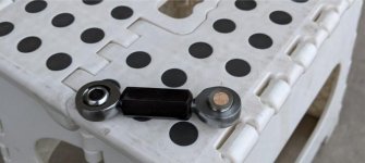

Well today I did some prep getting ready this morning putting the Spyder up on blocks so I could remove the connection links between the A-frames and the OEM sway bar. Late this afternoon the new bar showed up, and I installed the new links and put a bolt hand tight on one end. I had a wooden dowel sitting on the mancave bench that worked great to hold the spacers in place to push the bolt in. So that step is done. In the morning I will remove the panels and another guy in the RV resort is coming at 10 with his truck and ramps so I can drive up and swap out the bars and then will put it back on the blocks to put everything back together. So by 11 or 12 tomorrow it should be ready to go.
