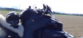

First - if you want to install a "better" windshield, you'll have to cut the lid of the glovebox - without that, it's not possible to fix it in a good looking and aerodynamic way & if it is fixed too high, so it looks "crazy" - the shield is only fixed on the handlebars (5minutes)
So I cut it - made a rubber-seal (from a window) and I'm now waiting for a "Lock" system from SHAD - only one key for the glovebox and the side case.
I use this smaller PUIG in the moment, but you could also use also the wider ones.
https://puig.tv/en/tuning-motos/carenabrises-universales-para-faros-no-redondos/windshield-upampdown
The new Aluminium plate for a topcase (mine is from a Peugeot-scooter) is lying "over" the maxmount and makes it 12 Inches longer it has the "form" of the max-mount and should be fixed with screws to a second plate under the max-mount- I wanted a case with a backrest and a black painted lid (triple-black-ryky), also some Red Lines on it (maybe with LEDs on the End) - you could use also a SHAD if you want..
Mounted Directly onto the plate with the caseholder is the seat-pad - as low as possible - she does not want to sit so much higher than me.
I've also now ordered black metal handlebars from a KTM-Bike - the price for these add-ons were around:
Shield ..150;
complete Alu-plate with Seatpad - 400;
Topcase with mountplate - 200;
