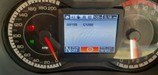

Current condition:
1. DPS Code Warning came on/off - with 100% of the cluster going out and resetting itself back to normal. DPS continued to come on/off for 1-2 hours of my ride (UO155) the same way. No steering problems noted - all normal operations. Spyder turns on normally. (VSS was noted but no code set - NO LIMP MODE CONDITION)
2. In addition – “Check Engine Light” came on after DPS stopped or reset itself - and also reset itself (UO155)
3. Then the “brake failure light” code came on (C1282) and currently remains on - even though the emergency brake releases and set normally - light remains on with code warning.
4. Disconnected (+/-) battery terminals, which apparently reset #1, but the check engine light still comes on/off whenever it feels like it. Cluster seems to be working normally even though codes are not showing (except as noted above).
5. I looked at the parking brake switch, cable, and motor that sets to light when engaged and sprayed it with some electrical cleaner. FYI – sound was not working prior to electrical cleaner intervention if Spyder was shut-off without setting the brake, but now is making the beeping sound. Cable seems normal in operations.
ANY SUGGESTIONS AS TO WHY EVERY CODE IN THE BOOK CAME ON AT THE SAME TIME?

Typical scenario when battery voltage is low or terminal connections are not good. If you can check the voltage drop when cranking this may tell you what is up. If voltage drops below 11v during cranking it can set off all kinds of bells and whistles. Not saying it's the only possibility. But it's where I would start. The Spyder is extremely sensitive to low voltage.
Looking back on this, with all those lights & warnings coming on like that, it STILL sounds a whole lot like you've got either low voltage in your battery OR the battery isn't earthed/grounded to the frame properly or well enough?! :dontknow:
Being a 2011, I wonder if at some time in its history, someone's stripped or otherwise reduced the effectiveness of the 'under-seat' ground connection where the battery is earthed to the frame?? That earth/ground strap is secured to the frame with a bolt into a riv-nut type fitting, and MANY of these early Spyders had very similar problems to yours because that earth/ground connection wasn't tight &/or firmly affixed to clean, bright metal.... But the battery usually did suffer very quickly?! :rolleyes:
Another thing I'm noticing more'n more these days is poor soldering/crimping of the terminal connections to the cable ends, especially on the 2013 & earlier Spyders, altho not exclusively.... :banghead: It seems that (maybe in an effort to save money?? :rolleyes: ) when whoever makes/supplies these heavy power cables & they fit the terminal ends onto the cable, they either don't heat things up enough, use an appropriate flux, or use enough solder, cos I've seen more than a couple of dozen in recent months where the bolt holding the terminal to the frame has been tight, but wriggling the cable itself revealed either a very poor connection or effectively none at all, with the cable effectively just pushed into the socket on that end of the terminal?! :mad: I guess this could be due to age &/or vibration over the years, but some of the Spyders I've seen it on have had very few miles on them, little work, and yet the cables aren't properly connected to the terminals, but the terminals ARE fitted securely to clean & bright metal on the frame, often with star washers included to make sure they've got a good connection and won't ever vibrate loose..... but the next joint up the line is the one that's now dodgy!! :cus:
Just a thought, but it might be worth checking every cable end you can find; &/or getting an auto electrician to look at the bike to see what's going on, rather than relying on the 'often clueless or poorly trained' dealer techs.... Just sayin' ;) If nothing else has fixed it, then it's gotta be worth a shot, doesn't it?? :dontknow:
