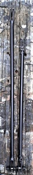

I also fabed up a longer brake bar and moved the floorboards forward 100mm, the last notch. Now my knees fit into the scallop in the tank and dont sit above the tank. So should be interesting.

Here is the bar I fabed up, if anyone is interested. I am not really a good mig-welder but it should do the job. Sprayed it with some Zinc.
WX has turned to not that flash for a few days with winter conditions here locally. Maybe in a few days I will get out. haha.m 4 1318206387.jpg
