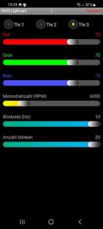

I was not happy with the rev-counter on my 2020 F3-S with the monochrome cluster, the F3 runs 2 times into the limiter while overtaking some trucks
so I mounted the shiftlight-pro from HealTech, it gets its signal from the CPS-wire, is connected via bluetooth with my mobile and I have several ways to calibrate the shiftlight.

it´s just a nice-to-have for me. The monochrome cluster of my 2020F3-S has the counter very small on the right side at the bottom, so out of view. Together with the mounted PedalBox your are going very fast near to the limiter in the first 3 gears.
similar to BertRemington´s Mustang I set the "highest" warning (red flashing) by 7500rpm, so 600rpm before the limiter
