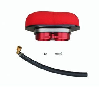

lamonster, I was wondering if you've considered doing something like the Evoluzione Race Air Filter mod. I saw it on Danimal's Spyder at the Michigan Owners Event a few weeks back and it looked really nice. The breather tube gets routed right to the base of the filter so the oil gets drawn right back in to the engine. Also, it is much smaller than having the air filter box so the engine compartment is much less cluttered and I would have to believe that would really help alleviate some heat build-up under the panels. I would think about it but I'm not really a hot-rodder.
Pic of the Race Airflow System
Yes it looks nice but now you're really sucking hot air. At least with the stock box it's pulling air from the front of the Spyder where the air is a little cooler.
On the 109 you gain about 5 hp by moving the intake air to the outside of the bike instead of the inside near the motor. If I was going to do a mod like this to get rid of the airbox it would be a "Cold Air" intake. You really need to pull the air outside of the Spyder where the air is much cooler. That would do more than this setup. If I got to wipe a little oil down every 6000 miles or so that's fine with me. :doorag:
