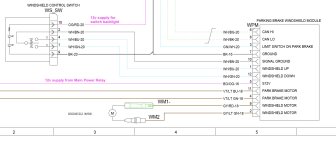

Well, it's not on the left handlebar like on your F3, it's down in front of you on the console. Sorry, but I have to cover all the bases.
Next, there is nothing between the switch and module except connectors and wires. See attached. Might just be a bad module, connector pin, or wire issue. Do you have an extended warranty on it? Did it ever work?
