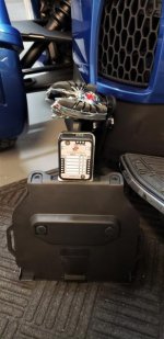

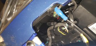

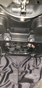

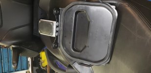

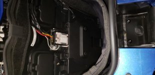

Do not have the USB switch installed yet but here is my FZ-1 location and where I connected the trigger wire to it.
MedutPG, thanks for the pictures, very helpful. On the connection for the trigger wire, I have having trouble orienting towards where the picture actually is . It looks to be on the left side (left when on bike), and just below the headlight, Is that the right location? Also, do you happen to know what circuit that taps into?

You are right. It is on the left side (sitting on bike) just below the headlight, remove black panel and there will be two connectors. One is a five wire connector and one is a two wire connector. I tapped into the two wire orange w/ red stripe going to the frunk light. Look over toward the outside and find the 2 wire harness and connector that goes to the frunk light. That is hot whenever the key is on. The one you want to tie into there is orange with red stripe. I used a posi-tap blue connector to tie in (do not cut any wires) https://www.amazon.com/Posi-tap-Connector-16-18-Gauge-Wire/dp/B00389R8KU
