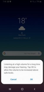

I use the Google Play Music app. It does not have a volume control in the app. Not that I can find anyway. The volume control on my phone makes a big difference on the volume from the Spyder. Just note I am not plugged into the Spyders usb. If you plug in the phone locks and the volume is not adjustable any longer. Everytime I try to increase the volume higher than 60% I will get the notification. The speakers and amp are stock. I have never noticed any stuttering from steering or fan.
