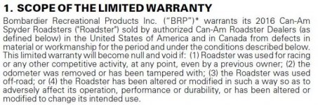

As you quoted. The marketing hype for the hitch says "maintains vehicle warranty requirements". Why would you change the wording and the meaning by saying that an aftermarket hitch will void your warranty. Any and all aftermarket accessories that you add to your Spyder that cause a problem. That problem is not covered by your warranty. It did not void your warranty. You still have warranty coverage for the rest of the Spyder that was not damaged by the accessory. Adding a BRP approved accessory and that accessory damages your Spyder. BRP will fix your Spyder even though the damage was not caused by materials and workmanship of the Spyder itself. Maintains vehicle warranty requirements. That statement refers to the warranty scope statement. Specifically statement (4).
