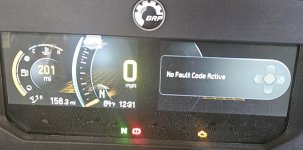

I'm having the same problem with my 2022 RT Limited with 2000 miles. Check engine light on but no codes displayed...
Sorry Desert, but I'd guess that your 2022's issue is probably not going to be the same as that which caused this on the OP's 2012 RT; but then again, that Check Engine Light does tend to be a bit of a 'Catch All indicator' for a whole range of issues - some of concern, many not... :rolleyes:
Is there anything else you can tell us?? Any momentary flashes of other lights maybe? Engine surging issues?? Anything?? :dontknow:
