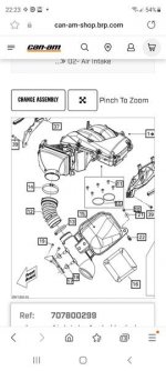

I am searching for the formed air intake, part number 707800307, for my 2011 Spyder RTS, but it has been discontinued. I have been searching everywhere I can think of online, and my dealership is also looking for me, to no avail. Has anyone had to replace this part since it has been discontinued? If so, where did you get it? Right now it is patched, but I don't know how long it will last.

I have attached a copy of the parts diagram, it is part number 12 in the diagram. I have also attached a picture of the cracked hose.
Pics of formed air intake

Thank you so much for this information! I do have a call in to my dealership about the part from the 2013. Looking at the parts diagram on the BRP site, it looks like the exact same hose. They are going to check that out for me and see if they can get it. According to the catalogue, I would have to purchase the entire Resonator assembly as the hose is not sold separately (makes no sense to me), but I could do that as my husband has a 2013 RT Limited, and he could have spare parts for his. If the 2013 part is not compatible with my 2011 assembly, I will pursue the ECU upgrade. I don't really need more power, but I do want to ride worry free.
