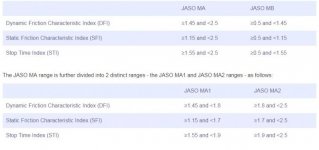

I contacted Redline themselves to see if there 10w40 motorcycle oil was rated for "MA2"
Here is there reply:
"Thank you for contacting Red Line Oil, the 10W40 Motorcycle Oil would satisfy the MA/MA1 wet clutch compatibility not the MA2"

Consistent with the information on the bottle. I would have been surprised for them to say anything else.

Sorry, not trying to get on you about it. Who knows. Sometimes I do research on a product and what they tell me does not agree with the published specs. So you never know One place I looked at listed the Redline Oil as having an MB JASO rating when in fact, the current product is JASO MA rated. Big difference!
I assumed that was old information which had not been updated. But there was no date stamp on it so who would ever know?
