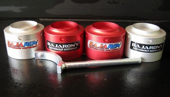

    NEW Product! 2013-2016 ST & RT Front Shock Spring Adjusters (Only for those Spyders WITHOUT Factory Front Shock Pre-load Adjusters)
    * Does your 2013 thru 2016 RT tend to bottom out, scraping the front on steep driveway approaches and speed bumps?
    * Do you get a lot of front end dive on hard braking or turning?
    * Does your Spyder sit too low in the front when heavily loaded?
    The 2013, 2014, 2015 & 2016 RT's come with no way to adjust the Front Shock Spring Pre-Load as they had in previous model years. That means you get the same amount of spring lift for 1 small rider with no luggage as you do for 2 heavy riders, all the luggage you can carry, and possibly pulling a trailer. Frankly, this 'One Setting Fits All Conditions' can be a bit frustrating as you have no ability to bring the front of your Spyder back up to the correct ride height when loaded.
    My Coil Spring Adjusters allow you to quickly and easily adjust the amount of pre-load (stiffness) and ride height of your Spyder. This not only helps to control lean and dive but brings your Spyder back to the proper ride height giving you more ground clearance which avoids hitting the front of your Spyder on speed bumps, driveway approaches, etc.
    Maintaining proper ride height also helps to maintain proper front end alignment. When the front of your Spyder sags with added weight it changes the front end alignment causing harder and less precise steering, lower fuel mileage and accelerated tire wear. This same condition can be created in the reverse. If you stiffen your front springs with non-adjustable spacers you will not be able to reduce the spring tension when unloaded. This will raise the front of your Spyder above the normal ride height, give you an unnecessary harsher ride and may create an 'Out of Alignment' condition.
    But now there is a great solution. These Billet Aluminum kits adjust easily, are simple to operate, and look great! And while these adjusters will increase spring tension, you will not experience a harsh ride because you can adjust the spring stiffness to your preference.
    The kit comes with everything you need and can include the option of a Spring Compressor tool set if you plan to install them yourself.
    Adjusters come in Red or Silver (though in the picture the Silver looks white)
    Adjuster Kit Contains
    1- Pair of Aircraft Grade, Billet Aluminum Shock Spring Pre-Adjusters
    1- Spanner Wrench
    1- Set each, both colors of BajaRon Decals (Multi-Color & Black/Silver)
    1- Set Rub Washers (Not Shown)
    1- Strip of Double Sided Sticky Tape (Assists in Assembly - Not Shown)
    1- Set of Installation Instructions - Non-Tupperware Removal Method.
    Price Delivered to US and Puerto Rico * $185.00
    Will Ship Worldwide - Contact me for International shipping cost.
    Coil Spring Compressors - $40.00 Refundable Deposit - If you are going to install these yourself you will need a set of Spring Compressors. Universal Spring Compressors are pretty readily available and can sometimes be rented/borrowed from your local auto parts store. However, these universal compressors are usually too large for the smaller springs on the Spyder. And the typical Motorcycle versions may be too weak to do a good job.
    So I have made up Custom Spring Compressor sets. These will be offered on a Deposit Basis ($40.00). This deposit will be fully refunded upon return of the compressor tool set in serviceable condition. Or, you can keep them if you like.
    Though it does make the install easier if you remove the front trunk, these adjusters can be installed without removing anything other than the shocks themselves. The supplied instructions are for doing this install without removing the front trunk.
