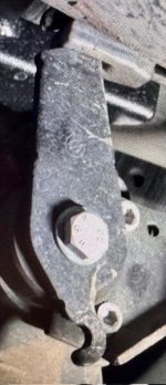

    Hi All,
    I would like to order a part, but I have not been able to find the part number. I've been going over parts lists but for some reason it is eluding me.
    I am looking for the small bracket that connects the parking brake cable to the rear wheel brake assembly.
    I can't find this part number and it seems odd, it's just a part. If anyone has any suggestions, I would be grateful for any help.

    What’s wrong Jim, did your bolt fall out? That piece is not a separate part, thus no part number. It’s an integral part of the caliper assembly. However, read through this thread and try to contact Joel The Biker by PM if he’s still around. He’ll make you one. And reminder to all, keep checking that bolt.

    I was worried it may be part of the rear brake caliper assembly. It seems just stupid that you can't but a part. I did send a message to Joel The Biker and hopefully he can help. If not I don't know what my next option is. I don't have the part to reverse engineer it to have one made. I can't even find the part number to search for it.
    It is a long story on how WE lost the bracket, my wife has some part in it when she tosses stuff she doesn't know what it is from the garage she never goes in! I lost a lot more than just that part, but that was all from my Spyder.

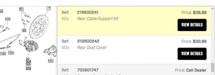

    Resolved!
    After doing as much research as I could and speaking with 4 different part houses I ordered what they all but one told me was the wrong part number. I ordered the "Rear Cable Support Kit" part number 219800241 and it arrived this morning. I really thought it was not going to be the correct part and I had been told by three of the parts houses that I would need to purchase the entire rear brake caliper assembly for around $500.
    I opened the box and I saw the part I was expecting - the bracket that holds the parking brake cable in place, and my heart dropped; but then I noticed there was more in the packaging once I got past the outer wrapping. It is the entire assembly for the parking brake connection to the rear caliper.
    Already installed and I am ready to go. The part cost about $40 and I was happy to pay it.

    Thank you all who helped. I hope this thread may help someone else in the future.
