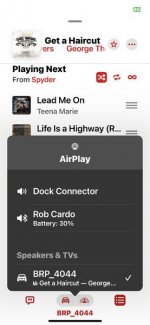

    So, I picked up my 2024 RT Limited in February and apart from the already detailed issues everything else worked fine. I'm talking specifically about Bluetooth Music. So long as I started Pandora, Sirius, or music on my phone first, then it would play through my system speakers once the phone connected. Everything was fine yesterday until I turned off the bike to get lunch. After lunch I started Sirius on my phone and it played on the phone speaker, I then started the bike, and once the phone connected the music went silent on the phone speaker! It should have played on the bike speakers, however, it did not. The screen shows the play arrow and the forward and backwards arrows, but nothing worked. I disconnected the phone and deleted the Bluetooth on both the phone and the bike and then reassociated. Still have the same issue, not sure how to proceed, and getting really frustrated with the whole Bluetooth, Apple CarPlay fiasco!
    Added pic to show the media screen.

    I had the same issue. Finally, I noticed that my Spyder was linked thru the dock, not thru Bluetooth.

    Quote Originally Posted by Riplin View Post
    Mine does show handoff to BRP however still no sound
