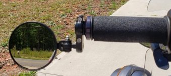

    Yes you can. Just loosen and move. However, with the T putting them forward will block your mirrors from view by the switch clusters. My solution to that was add Bar End Mirrors. Details at link in my sig.
