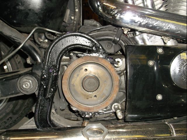

    Front drive pulley tool made from a C-Clamp, some scrap metal, and a piece of broken belt. I made this one to fit a Harley Sportster, but the same design should work on a Spyder too. This tool will cost you about $10 if you use a new C-Clamp. There are special tools for these jobs, but big bucks and who knows when you might get one. The old pieces of belt will lock up on the pulley and hold it without leaving a scratch.
    I think it was a 4 inch C-Clamp, but it wouldn't open up quite far enough to lock on the front pulley. I cut it and added about an inch to the back bone and it fit perfect. I didn't build it to look at. You can make a pretty one if you take your time. I just wanted to get the pulley off in a hurry when I made this one.

    Thanks for your suggestion but the splines of the sprocket are damaged/gone which allows shaft to spin inside sprocket. The bolt is attached to shaft that spins even when I put the bike in gear. I need to lock the shaft in place to break bolt loose.
