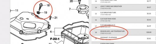

    Dunno what you're on about, I only know of the one Temp GAUGE on GoldWings too...
    But if you want to get all aggressive & accusatory about my supposition, surely the onus of PROOF is on you?!
    So you can't be "Pretty Sure"??? All you can do is correct a typo? I don't need to prove anything as I am sure, not "Pretty sure". The device that tells the temperature is in the air filter.
    2021 F3 Ltd , Magna Red
    Aug 2013
    SF Bay Area
    2,048
    Temp gauge/sensor in Goldwing air filter housing. As the placement of this item is what we're talking about because of the weird readings, we get and wondering how accurate they are.
