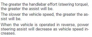

Your comeback prompts me to either prove my point or prepare to eat crow. I get to do a little of both!
From the 2013 RT service manual.
I have to eat crow and admit I was wrong above when I said the steering assist depended on steering torque, not steering angle. Steering angle is one of the parameters that the DPS uses to calculate the assist, as is also speed. The service manual doesn't describe the degree to which each of the inputs has an effect, but the implication is that steering torque is the primary one. That's the parameter that stuck in my mind. So let's see why steering torque varies as I surmise above.
