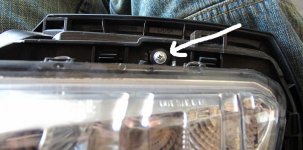

    May 2009
    Connecticut
    2,973
    You don,t have to fish any wires if you follow picture below-
