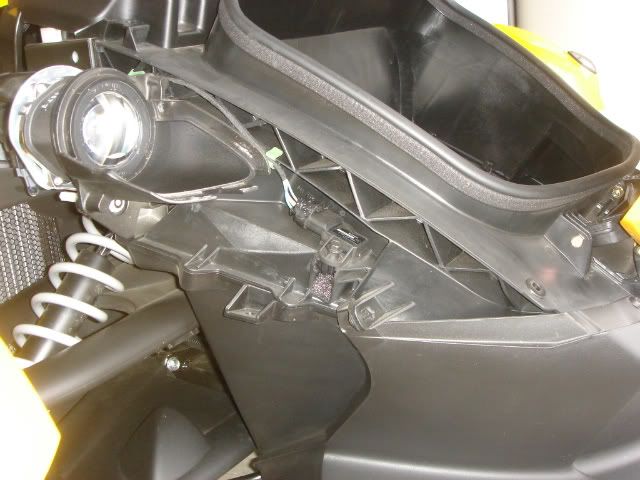

Where is the dash Temp sensor? Mine hit 109F !
Sensor is located on the right side, attached to the frame behind the vent in the trunk. You can peek in and see it. If the dealer installed it during setup, that is, some forgot. There should be pictures somewhere on this forum or SpyderTalk. I have found that the sun can shine on this and raise it very high, even in cooler weather. Responds slowly, even when moving, and never does really match the real world, but it is close and consistent.
-Scotty
Here's a few pics from another thread. The bottom pic shows the sensor looking through the right side vent, like Scotty said.
