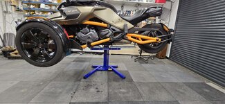

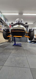

I use either my Big Blue Motorcycle lift, Harbor Freight ATV/Motorcycle jack or ramps just depending on the task.

where do you buy the pitbull
The original pitbull owner retired. The business was bought and continues with new owners. You will need to call them (google the number). I am not sure what product lines were continued after the new owners tool over.
