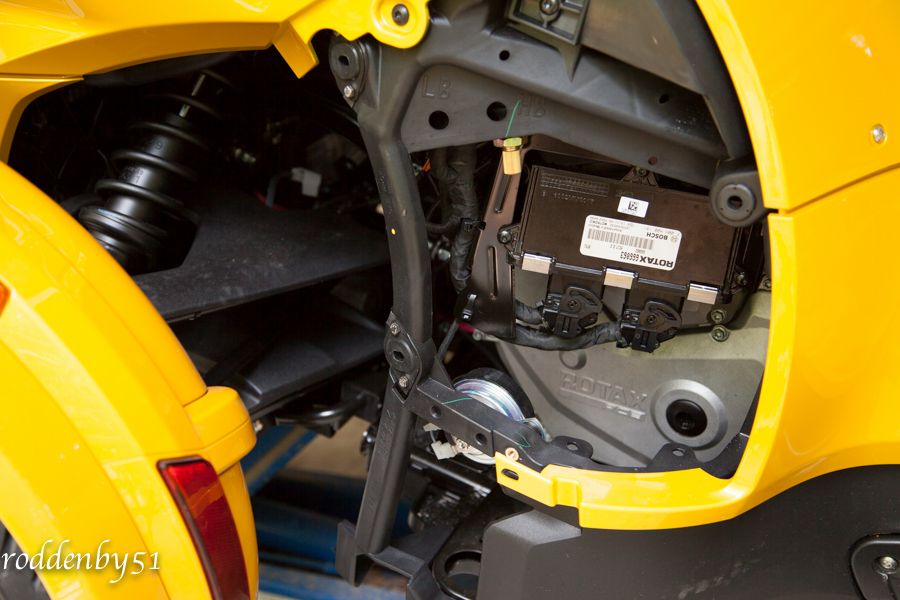

In the air:
All the necessary covers removed, waiting for a package from Lamonster Garage... a new BajaRon sway bar and links:
Mail finally arrived @ 2:30PM... all buttoned up, sway bar barely visible:

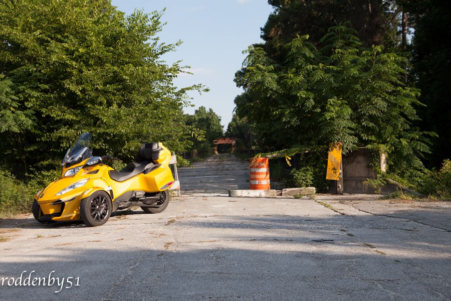

Two-up test of BajaRon sway bar today... wife approved! Her comment, Spyder is smoother in the curves.
Hillman Bridge, (old highway 90) Ellaville crossing, (Suwannee River) Madison County side. Built in 1925~26, abandoned 1986.
Since I'm still debating with myself over the need for the bar... :opps:
How much of a difference have you actually seen in how the bike rides and handles?
Hey Bob, my type of riding, the BajaRon sway bar isn't necessary for solo riding, but is a noticeable improvement with both of us on the bike. We are near the maximum recommended weight limit, and I consider the BajaRon sway bar a safety/stability item. Pilot control and passenger comfort in corners is well worth the price/installation...
