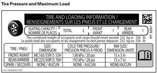

I haven't checked to see what the recommended pressures are for the Kendas on 2020 RT's, but going off earlier models pressure requirements, I'd expect they'd need something in the vicinity of 17 psi up front & 28 for the rear, but not be 'ideal' with anything over about 20 psi up front or 30 psi, maybe 32 on the rear if you are really loading your Spyder - and regardless of the actual pressure or tires you are running, the fronts should ideally be within about 1/2 a psi of each other too. ;)

So that vibrator that somebody is holding to my left leg and belt guard at 75-80 mph is actually the tires? 15 and 28 psi on the tires as stated in the manual. I think the belt may actually be slipping during this time.

I just replaced tires all around, all Vredestein. The dealer aired the front tires to 20 and the rear to 28. So, I guess the tag is correct.

The dealer Tech didn't check to see what tires you have now and used the PSI's for the KENDA tires .... Auto tires don't work BEST at higher PSI's .... So Please lower the PSI's to 15 -17 front and 18 rear ..... you and your Spyder will be much happier after you do this ..... good luck .... Mike :thumbup:
agree with Mike, the pressures he gives, makes the ride way, way better.....15 psi when not fully loaded front, and rear 18, this will make you smile all the way
