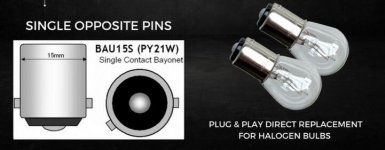

In order to do that he has to flip the wires around, it's a one post bulb in the picture.:dontknow: Guess he could make some jumpers and try one bulb out of place!
I took a snapshot of part of their advertising. The words say opposite but a picture shows slightly off center of opposite.
So if the pins are 180 Degrees opposite then just turn the bulb around. But if the image is correct then the wiring has to be changed.
Well Andrew, I guess I'm going to have to disagree that it's a polarity thing. Because the bulb only goes in one way, the center pin is probably positive already and the base is negative, as it should be. Instead, I think that the issue is that the bulb is not compatible with vehicles that have a CAN BUS system. The description of the bulb that you posted about states that.

I also think the problem is polarity.
For some reason, BRP often gets the polarity wrong on bulb fixtures, after all, it's less relevant for the incandescent bulbs.
I remember when I switched to LEDs on my 2014, the right side worked fine and the left side needed to reverse the polarity.
And my 2020 GPS wouldn't charge, even though it was connected directly to the aux power circuit with factory connectors.
Again, I had to follow Mr. Scott's best engineering advice and reverse the polarity.
The point being that even though the bulbs will only fit in the socket one way, there's still a good chance that BRP has wired them backwards.
The CanBus issue will cause hyper flash, (fast winking) and can be fixed by adding a resistor to the circuit if needed.
