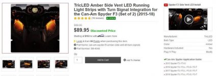

As many of you know, BRP changed the way the wiring in the Spyder F3 is accomplished in 2019 related, at least, to the lighting. In 2015-2018 there is a mid-point in the wiring harness under the upper body panels roughly behind the fog lights that you can plug into for accessory turn signals etc. In 2019 they removed the signals from the mirrors and moved them to the front fenders, simultaneously getting rid of this connection point. This is why you see a 2015-2018 only note on some of the LED kits out there (like the vent sidelights from Slingmods)

Side LED Signal Lights: https://tricledusa.com/collections/...signal-up-to-2018-only?variant=39511983063085
