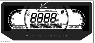

The button under the seat is to be pressed by the weight of a passenger and it stops the nanny computer from going into full sport mode when it is pressed. You can check this by pressing it with the seat off and watching the instrument panel to see if it goes to sport mode without the blocked traction control icon coming up. It will toggle the traction control in any mode, but sport mode would be the most noticeable.
The reason to block the button, if you wish, is that strapping a small, light weight, gym bag with only a light rain jacket or something like that, to the passenger seat with bungee cords or a ratchet strap, will also press the button and keep the nanny from allowing the full sport mode performance. Mine is blocked with an old cover from an electrical box.
It does not change the power or performance. It toggles the traction control of the nanny computer.

I was trying to select "SPORT Mode" last week and my 2022 RT S2S would only give me "ECO" or "Standard"
Yet the Owner's Manual page 51 shows all 3 Modes. I couldn't find anything in the owner's Manual that explained how one gets Sport Mode to activate.
This seat switch thing seems to make sense. I'll have to remove the seat and see if I can select SPORT Mode.
BTW here is what the manual says about SPORT Mode:
They copy and paste a lot in manuals, should be actual per model. RT doesn't have sport mode, only F3S
They copy and paste a lot in manuals. Should be actual per model. RT doesn't have sport mode, only F3S
Exactly, no Sport mode on the RT's. Although @captcharles does not specify his model.
Bummer... :sour:
I guess there is a Pedal Box in my future :ohyea:
I don't have a Sport mode on my RT but I can almost guarantee you there is no way BRP's Sport mode compares to the Pedal Box. I actually have the Pedal Commander but they are functionally equivalent. You won't believe the difference.
