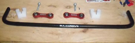

6) Bajarons sway bar- As many say, do it when you can take your time, I did not and was a bit frustrated. But it is on.
A couple of tips that may help others:
  1. Removing the #23 bolt and #42 nut in order to remove the grill moulding, drove me nuts. Looking straight on as per the diagram in the instructions I could not see it, is actually covered . Finally saw it from underneath and removed a push pin to get a wrench on it better. The purple wrench shows the area in question and then the bolt exposed.
  2. Removing the heim end links - takes a 13 mm wrench, actually two. Two ratchet end wrenches, if you have them would work much better than two open end or box end due to the space constraints.
  3. Jacking it up to the required 20-22 inches is quite interesting...I lowered it back down onto blocks as soon as I could. I saw another members set up, if I had to do it again, I'd do the same, jack and put all three wheels on blocks, jack again, more blocks. The pic shows it stable, I had to raise it up another foot over what it shown to slid the bar out.
