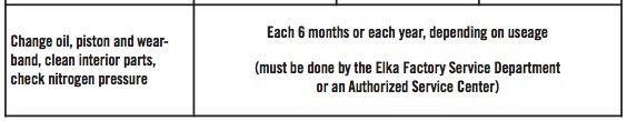

Not sure if you know this but I have heard from many people and I am not 100 % sure that to keep the warranty you have to take the shocks off every year while under warranty and send them back to the factory at your expense. Please dont quote me on this as I said I am not sure if this is true or not..... it wont hurt asking the factory rep.
The following are the warranty and service as stated in the manual. I don't find anything that says you can renew or extend your warranty beyond 1 year. This doesn't mean you can't; just that I don't find anything in writing.
View attachment 155600View attachment 155601
Thank you for clearing that up my concern would be how reliable are these shocks and maybe some one that has them on can answer do they need to be serviced every year to keep them performing up to standard my idea of a shock would be anything up to 80,000 miles the should perform well with minimal deterioration.

I'm with you; I don't want a shock I have to service every year, or even anything close to that.
Hopefully we'll hear from others with actual experience.
Rob
Hi spydernatic,
Re: my idea of a shock would be anything up to 80,000 miles the should perform well with minimal deterioration.
I'm with you.
I was just about to pull the trigger on a full set of Elkas. No Thanks.
I'll find something ( even if just stock when necessary ) before I buy something that has to be serviced that often. That's just nutz,
