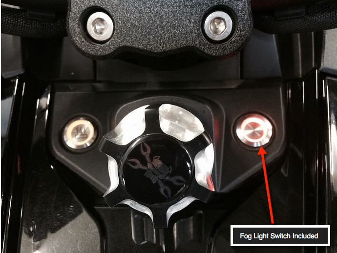

Hi all..first post from new Spyder F3 owner.. Just got my 2016 Spyder F3 Limited and don't know what this plug is for. It is just right of the ignition switch. Right now there is a black plug it is under. The plug has four small wires attached to it. It's not the grip heater switch, that's on the left side. Any help or ideas are appreciated. Thanks..really enjoying the forum!!
If you install fog lights, that's the place for the switch. It plugs into the space you're talking about (that black plug pops out). If you take the side panel off you'll see the connector where you'd plug the fog lights in to. There's one on each side.
I bought Lamonts LED fog lights. They're plug and play (easy install) and have all the pieces and parts you need including the switch.
