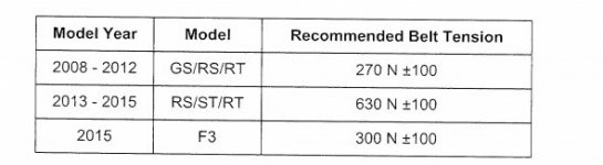

What Spyder model and year do you have?
Here is the most recent BRP service bulletin on the belt tension spec.
