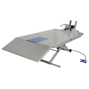

If you happen to own this style lift table with removable wings, you can easily widen it for a Spyder by replacing the (3) support tubes. My original tubes were 49" in length. My new tubes are 1" (1.31actual OD) threaded black pipe 60" in length with pipe caps on each end. All from Home Depot Plumbing. Approx. $100 bucks. Bike shown is an F3.
That is impressive. Which lift table is that / where did you get it. Is it compressed air driven?

Thank you for your post. I have a similar lift to yours which I was thinking of selling it for a Big Blue lift.
Would you mind giving me a couple of measurements? First is height of your table fully collapsed from the floor to top of the ramp. Second is what is the length of the removable approach ramps?
Your approach ramps appear to be somewhat longer than mine.
1. 7-1/4" 2. 20"
BTW, the bike is backed on because when driving it on forward, the air dam contacts the ramp.
