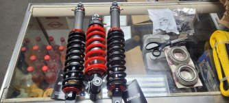

After almost 5 months of jerking around with M2 and pulling the plug just before he announced shutting down, we can finally move forward! It only took 7 months from the start of this project, and now riding season is pretty much over... Elka came through and delivered ahead of schedule. The language barrier was challenging at times, but I'm looking forward to doing more business with them in the future.
We opted for Stage 2 with the Sport/Touring tuning. I wish they offered Stage 4 or 5 for the RT though. I will report after we get some miles on them!

Looking forward to hearing what you think. I replaced my front a few days ago and really like them, thinking about adding the rear.
