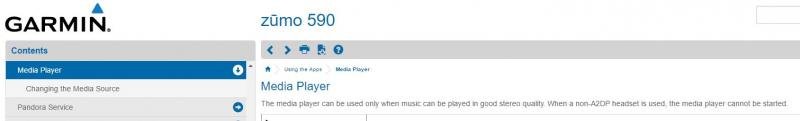

The Garmin Zumo 590 is definitely not mono however. When having the Sena 20s hooked directly to it the sound was stereo, the pandora app playing through it was stereo also. see attached.Capture.jpg

Your right the gps is stereo. It is even connected to the radio in stereo. But only mono comes out the radio.:dontknow: Even worse it does not combine the left and right channel. It uses only one channel and put it out both left and right speakers. You can test this for yourself. Get a stereo test mp3 and try it out.
