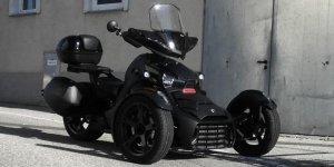

finally I found the right Can-Am fairing for our Ryker "ST" - the way how to fix it on the (higher) handlebars is really perfect !!
They offer three different sizes of shields, I got the midlle and the sport-Version - also very easy to change ..
After 10.000 miles without any Problems I would recommend the following ( if you plan to go 2up "on tour")
1; use higher and wider handlebars - a huge different to ryde - much better handling !
2; change the sway bar ..but the front shocks are OK ..
3; you need the "strongest" shock on the back what you can find - also the FOX must be adjustet in the hardest position for 2up !!
4; have a look that you bring most of the weight of your luggage to the center of the bike - so you need a real large tankbag ..
if the Ryker is "full loaded" on the back - the VSS is overwhelmed in the curves ..
5; depending of the "size" of you and your passsenger you need a lower seat on the back and a higer for the Ryder (my last work now..)
6; I told my neighbor that I need only two minutes to make a "Tourer" of my naked Ryker - you see it her ::thumbup:
https://www.youtube.com/watch?v=gtQsis3FES4&t=11s
so - she is a little faster uphill (and downhill !!) than our old Spyders (GS/RT) - we reach around 180 miles till the next tank-stopp - needs no oil - the belt in the gearbox was checked now - should hold another 10.000 miles (longer than I expected) - my wheelnuts are still OK (was built 2018) ..no real other problems till now ..
I know that some people here don`t believe this - but this is the perfect 3-wheel-tourer ! (specially for the Alps)
( OK - we are both slightly weighted)

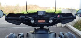

its an original Can-Am product, I ordered it from my dealer ..(it is just in the rong catalgue :( )
four different colours - be carefull to get the same (adrenaline ?) if you order the RED .. the clamps are included ..
three different shields - I`m 176cm - 5 ft 10" the middle size is a little too high with the original seat, I do not want to look through the plexi ..
here you see from what modell you could use the handlebars - it is a 21mm Standard, like most of the motorcycles ( I use an old APRILIA one)
if you use wider handlebars the original mirrors "work" much better I do not change it now ..
first pic is with the highest shield - the red one is the lowest ..

That looks like my dream tour and you proved it can be done on a Ryker.I still love my RT.I just want to know how you packed enough for 10000 miles on a Ryker and did anything else break other than that flat tire.
one of the last things was to bring the driver seat higer ( 2inch over the comfort seat) the seat cushion is finished - we have now the same niveau, which looks really better in 2up-ryding ..

I'm interested in that adjustable windshield and I believe you mentioned it somewhere else. Can you give me the name of that windshield in the third photo? I believe it is the photo: 50.jpg? The stock windshield is not high enough for me and I like the design of the one you have. Sorry if I am asking you to repeat something that I should already have seen on here someplace. Your designs are fantastic.
this is the PUIG up&down .. the new one is the Can-Am !! deluxe fairing
https://puig.tv/en/tuning-motos/carenabrises-universales-para-faros-no-redondos/windshield-upampdown
https://can-am.brp.com/off-road/ca/...luxe-fairing-for-g2-except-x-mr--6x6-g2l.html

I really wanted to get the same windshield, until I found that you had to cut the front glove box lid quite a bit for it to work. Maybe there's a different solution?
I did not know about having to alter the glove box lid. Surely they would not make one specifically for the Ryker that would require you to modify the box lid?
I "cutted" the lid in two pieces, the first what I did when I got it ist a cheap plastik-lid - is done in 5 minutes .. than you can install each Kind of fairing in the right Position !
