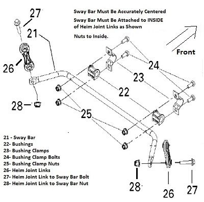

It has come to my attention that a few RT Sway Bar customers have had an issue with bolt length on the bar end to Heim Link Joint connection (#27). This situation does not appear to be wide spread but I do not want it to occur at all.
I am not sure if the problem is due to a variation in bolt length, bar width or a combination of the two. None of the RT's I installed this bar on had this issue. It is very important that the bolt is long enough so that threads extend past the end of Nylock nut. Any amount of thread beyond the end of the Nylock nut is sufficient.
At the risk of blowing this out of proportion I want to address it here on Spyderlovers. If you have an RT Sway Bar installed on your Spyder, please check for the following POSSIBLE condition. This is by no means universal and you will most likely find that your install is fine. If not the fix is quick and easily done.
This Issue DOES NOT exist on any of the RS, GS or RS-S Sway Bar installs.
The Nylon insert in these nuts are designed to overcome vibration and prevent the nut from backing off the bolt. If the bolt threads do not extend beyond the end of the Nylock nut this 'locking' action does not occur and it is possible that the nut could come off.
All current and future RT Sway Bar kits will come with a set of extended bolts to prevent any possibility of this occurring in the future. But I want any current RT Sway Bar owner to be very sure that this condition does not exist on their Spyder.
If you have one of my RT Sway Bar mounted to your Spyder I encourage you to check your Heim Link Joint to Bar End nuts/bolts right away. This is very easy to check, very easy to determine and very easy to correct if the condition does exist.
If you do need to install the longer bolts there is nothing more to remove or disassemble. This connection is easily accessed without having to make any other changes.

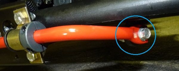

This is the connection we are looking for at the end of the Sway Bar. Your bar will be black and mount to the inside of the Heim Link joint. You just need to determine if there are threads extending beyond the nut on the inside of this connection.

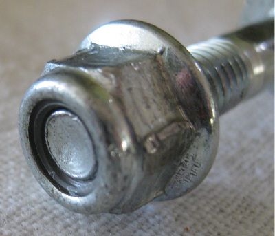

If you have just a thread of two extending beyond the end of the nut as shown in this picture, the connection is good and the nut is working as designed. You may have more bolt threads than this extending beyond the nut and this is also fine. The only condition that is not good is to have no threads extending beyond the end of the nut as shown in the picture below this one.

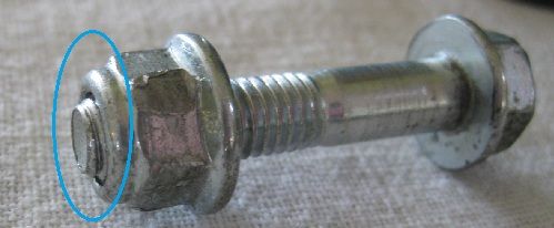

No threads extending beyond the nut is not acceptable and needs to be corrected. (Picture Below)
There are NO bolt threads extending beyond the nut in this picture. This is the condition that we want to correct. If your install looks like this you need a set of extended bolts. Close is good enough in hand grenades and horse shoes... this is neither!
If you have already installed one of my Sway Bars on your RT model Spyder and you find this to be an issue, or if you are not sure or have any questions please PM me here at Spyderlovers or email me at [email protected] right away. If needed I will send a set of extended bolts right out to you.
