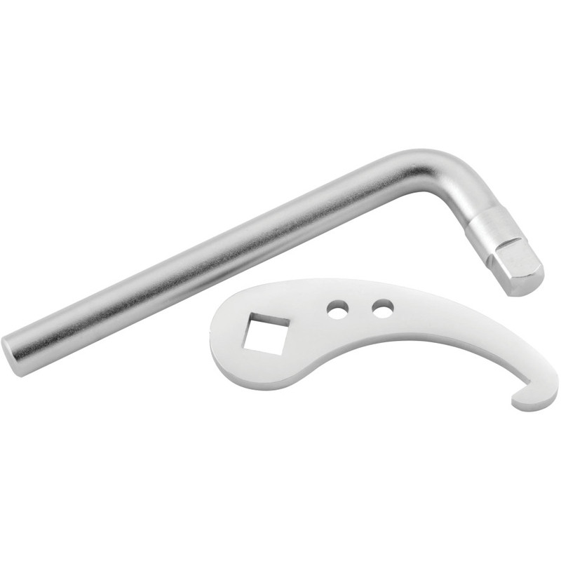

If you go to adjust the spring on your rear shock, I use this type of spanner wrench (4th photo). I dont use the little bar that comes with it, I use a ratchet wrench with it because it gives you more leverage. Because it ratchets, it also gives you more space to turn the rings. Also, its much easier to turn the rings on the rear shock if you jack up the rear so that the tire is off the ground, (it takes compression off the spring).
