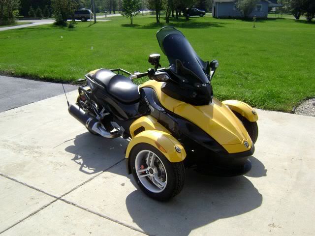

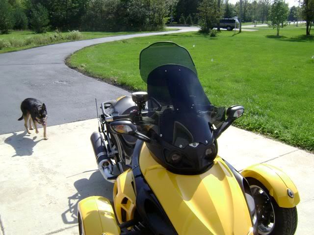

This is a pretty old thread but it contains the pictures of my Spyder with GIVI bags. The last post in that thread contains a link to MRB's install of the rack, which has some good info and pics too. Here are a few recent pics of my Spyder with no bags on the rack.
The rack can be installed or removed in about 20 minutes. There are three main sections of the rack, a tailpiece and two side pieces. Four nuts and bolts hold the three sections together. The tailpiece is attached to the Spyder with a screw and the threaded insert that holds the tip of the underseat pan to the Spyder. The side pieces attach to the Spyder with the front bolt that holds the seat / grab rail assembly to the Spyder and the bolt that holds the muffler clamp to the Spyder. On the left side, they give you a bolt and bushing set to use that same mounting location sans muffler. Also, the turn signals relocate from the Spyder rear side covers to the rack tailpiece but they are basically plug and play.
I wouldn't worry about someone taking the bags unless you are parking in a really bad area. (In which case, I wouldn't want to leave the Spyder there either.) They are locked onto the rack and you need a key to take them off the rack. If you want really quickly removable bags that don't have a rack, you are better off with one of the many generic soft sided bags.
