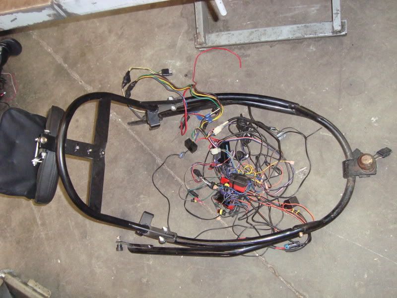

The Mel's Monster Garage (MMG) swingarm hitch would fit. Frame mounted hitches will not. The MMG hitch does not include the wiring harness and trailer isolation module like the factory hitch. The factory hitch has the special BRP connector, so it will fit the RT-622 trailer, but will need to be adapted to other trailers. Other wiring would have to be adapted to the RT-622 trailer the hard way, since the wiring harness is not available separately.

I used the tongue harness for the basis of my adapter. This is the best thread on the subject, with a link to the pinout diagram. There is even a color code label on the tongue harness. To the best of my knowledge, nobody has been able to make any converter work to convert the separate turn signals on the RT to a trailer with combined brake/turn lights. My best suggestion is to add some turn lights (and wiring) to the trailer, and use a five wire plug (or five poles of a six wire plug). The Spyder has separate right and left brake circuits, so you just need to choose one. The other alternative is to wire the trailer tongue harness to your trailer directly, but then the trailer will only work with a Spyder RT. BTW, be sure to leave enough wire. The Spyder connector is a long way from the ball.​
